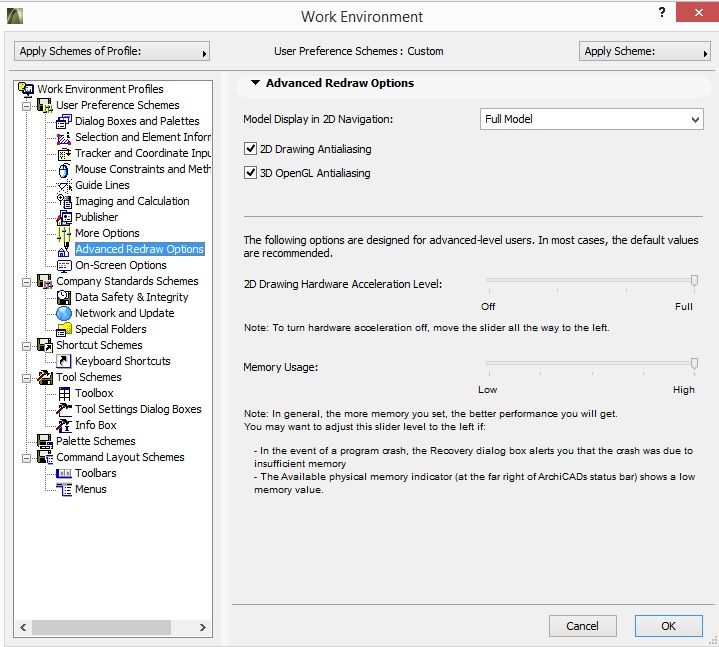

You can check and experiment with the options in the Advanced Redraw Options page of the Work Environment Dialog, like 2D Drawing Antialiasing, 2D Hardware Acceleration and Memory Usage.

Thank you for the answer. I set the following options in Archicad and updated my graphics card drivers, but it is almost the same.
Try to turn OFF 2D Drawing Antialiasing and set the 2D Drawing hardware Acceleration level to OFF as well, see if that helps.
