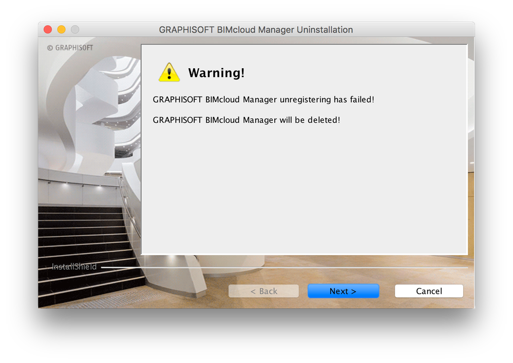

Running the uninstaller of BIMcloud v19, v20 and v21 components will warn you with the following message:
Workaround
You can ignore this message, click on “Next” and finish process. Your BIMcloud components will be uninstalled completely.
