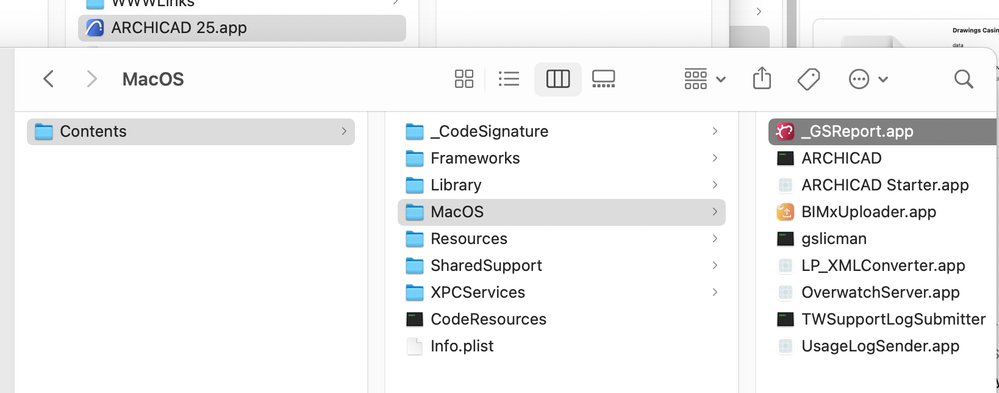

I suggest that the bug reporter should be an opt-in feature controlled in Archicad settings. Until that time:
Easy way to disable the Archicad Bug Reporter app GSReport on MacOS is to
1. Go to your Applications folder > Graphisoft > Archicad
2. Right-click Archicad app and select "Show package contents"
3. Navigate to Content > MacOS
4. Rename the "GSReport" app here to "_GSReport"
Easy as that - you've just saved yourself unnecessary additional annoyance when your AC crashes. 👍🏻
