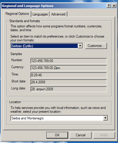

Ok, steps I followed:
1. Control panel -> Regional settings
2. settings as in attached gifs,
3. Settings in file C:\Program Files\Graphisoft\ArchiCAD 11\Add-Ons\XReadCfg.txt:
DEFMACTOWINCONVTABLE = 29 (either 7)
4. HKEY_CURRENT_USER\Software\Graphisoft\ArchiCAD\ArchiCAD 11.0.0 INT R1\Font Description -> font script code = 238 (either 204)
Combination with cyrillic keyboard as default text input or english - both don't work.

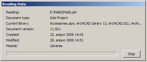

Only cyrillic letters I can see in whole archicad is in ONE window, image attached, and it is about date name (it is spelled correctly in fields "created" and "modified")...

ArchiCAD is not a UniCode software fully, Only text tool work properly.
Follow instruction as in wiki, you might already done that. You should be able to see cyrillics.
This does not mean that you actually can write cyrillic text (for example zones and object fields).
What is missing in that wiki (xp part) article is one tiny setting in advanced tab, see image.
Depending your regional default settings this can totally fuck your reading experience.
In my case all non ascii chars are twisted to cyrillics and some other non unicode sw gets fully cyrillics.
