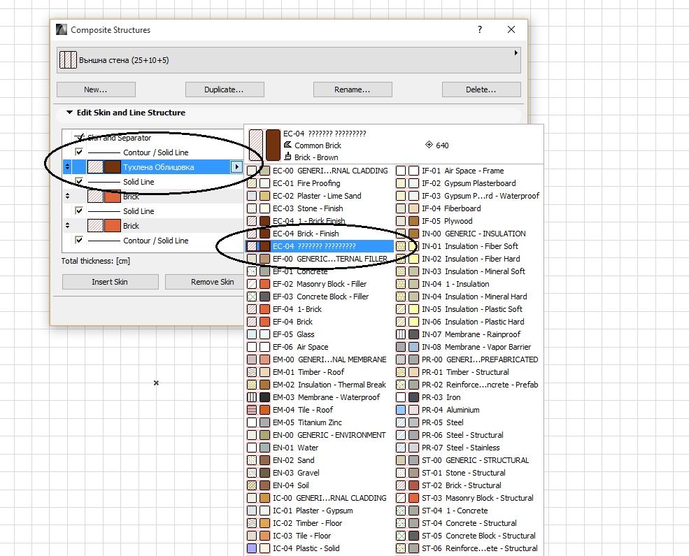

I'm currently having a problem with materials I have named in Cyrillic and using them in Composites.
When selecting them in Composites they appear as ??? ???? as each question mark represents one Cyrillic letter.
I'm using ArchiCAD 19 Education version on Windows 10 x64
Thank you!

I don't have a solution, but I can offer some hope. Greek Cyrillic letters do appear properly in INT ArchiCAD 19 using Windows 7. Might be an issue with the educational version?

Stefan,
Please read this article:
I hope this helps.

@NCornia
Thank you very much! The guide worked, although It was a bit different on Windows 10.
I searched for something like this but strangely I didn't find it on Google.
Thanks, again!
