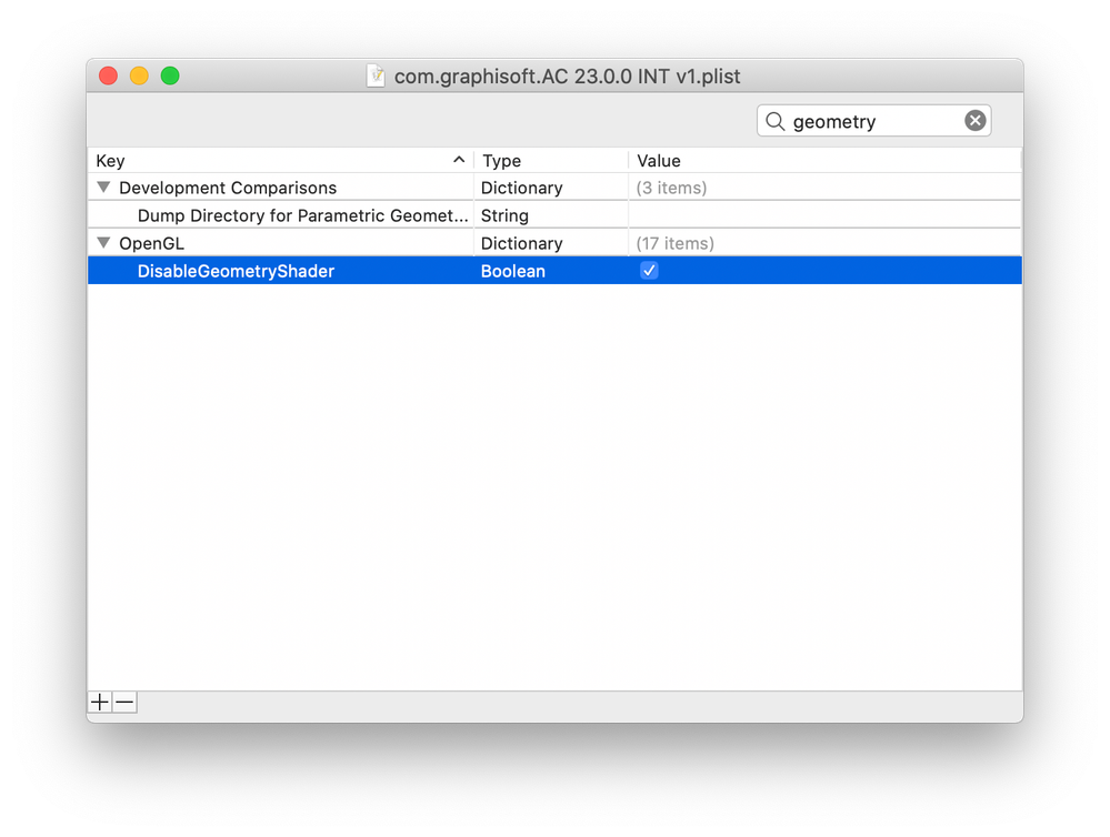

Disabling the Geometry Shader will result in the following feature loss
To disable the Geometry Shader, we can use a Preferences editor program to edit the required PLIST. For more details, please check out our article on this topic.

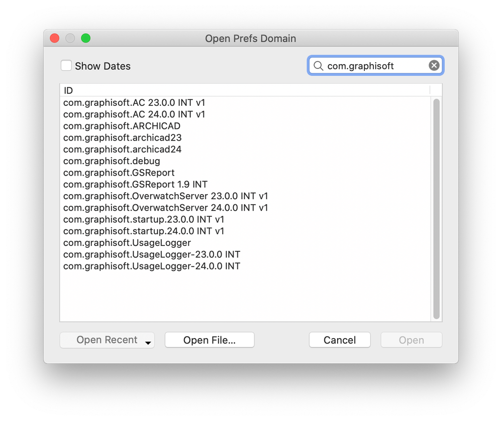

We will demonstrate the workaround using Prefs Editor:
Once the modification is made, it is automatically saved to the PLIST file. We can close the window and exit Prefs Editor.
To reenable Geometry Shader, we can go through the same process as described above. In step 5, untick the checkbox "DisableGeometryShader" to enable Geometry Shader.
