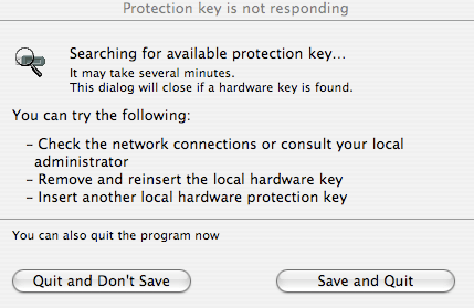

Today I have been getting the following error messages while trying to run AC11 on my MacBookPro.
a) While the AC11 is in use the attached error message will pop up which will leave me no choice but to quit and restart AC11. Then this message will pop up again after a few minutes. OR
b) Soon after I restart AC11 another message will pop up (not attached) saying Protection Key not found and leaving me the option to Quit or Run Demo.
This happens even after I restart my computer. I even tried plugging in the WIBU key into the other two USB ports. This key by the way is an old one I have been using since AC9. As far as I know I have the latest version of AC11.
Thanks for your help.

Sometimes these things fail.
It can come at an unfortunate time, like the weekend, but that is how it goes when you are in the big time.
You seem to have examined the usual solutions - can you test the key on another machine?

Run Applications > WIBUKEY > WkConfig
A window should appear with the Contents tab showing:
Computer: Local
WIBU-BOX: your wibu Key ID (USB)
Contents: some digits for Master and Added Data
It should show Driver Version 5.21 or greater.
If you don't see any of these things, then you either need to reinstall the WIBU software, or you key itself has gone bad.

I've had a key go bad, and the symptoms were the same as you describe. Initially it was intermittent, and removing/reinserting the key would cause it to recover. But after some time it would scarcely work at all, and it was replaced.

I did run the WIBU application within the Graphisoft folder which I discovered to be version 5.20. Then I went to the web page as you had advised and downloaded 5.21 and installed it. So far it appears to be working. Keeping all of my fingers crossed!

Once a key becomes unreliable, you need to get ready for a failure.

WIBU doesn't have an auto-update feature yet, so 5.20 must be what was installed on your system, which should have been OK. If things work after the 5.21 update, then I'm guessing that something got corrupted at some point (permissions, who knows what). Or, as Ralph and Dwight suggest, your key is just in the process of failing. Keep us posted.
