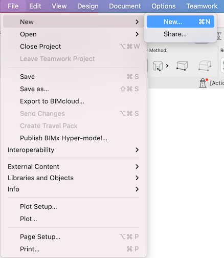

Missing icons - fixed
Affected version(s): All | Severity: Fixed in an update | ID: DEF-1023
Issue
Icons are missing from main menu and from context menu as well.
Solution
This issue has been fixed in Archicad 24 Update 2 (40xx)
