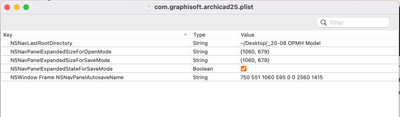

Eduardo Rolon
There is another wrinkle to the "Open Dialog not resizing" in that on the second file you open with the command the Open Window expands horizontally until you cannot see the "ok" and "cancel" buttons.
This persists on quit and the only work around I find is to edit the preference file for 25.

After upgrading to Monterey OS we discovered an issue with the Open and Save dialogs where the dialog width grows until it's wider than the screen. Until Graphisoft releases an update to fix this problem you can solve the issue with two Terminal commands as we describe in a Blog article we posted at this link >>
Eduardo Rolon
@T Simmons An alternative is to use "Pref Editor" to edit com.graphisoft.archicad25.plist were you can copy the window size from "Save As" setting into the "Open". As I've been able to figure out it is only the "Open" window that changes and it increases in size once every two times you use the open command.
T Simmons
Good idea. Just tried this approach which also works but both solutions still have the same issue which is that the Save As and Open dialog boxes resize to a wider length each time they're used. So no permanent solution yet other than to reapply one of these two options every so often to reset the dialog size. Hope Graphisoft has a fix to this in the next update!

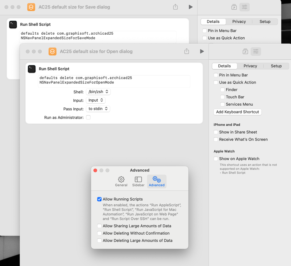

csongraf
Hi all,
for those who are unfamiliar with Terminal I've packaged the two Terminal commands into two shortcuts - now that Monterey lets me. So they can be run in a more simpler way.
The only thing You must enable is the "Allow running scripts" from the Settings.
The Shortcuts can be found here: OPEN and SAVE.
