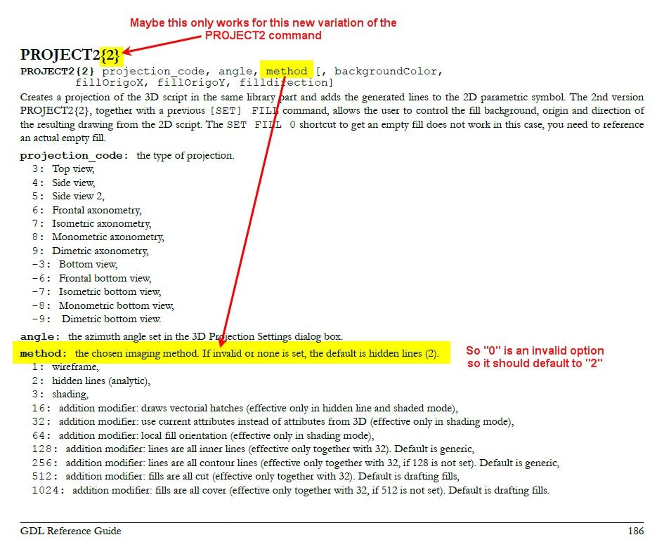

I found the problem (I had Richard send me the object).
In the 2D script is a PROJECT2, 3, 270, 0 command to show the post.
Works fine in all older Archicad versions but not in 20.
Needs to be ... PROJECT2, 3, 270, 2
Even though the GDL manual says if there is an invalid code then "2" will be used (see attached image).
I checked and it doesn't work with PROJECT2{2} either.
So I guess it is either a new bug there not using the default or AC20 requires a valid code and the reference is not updated.
Glad you could make it work.
