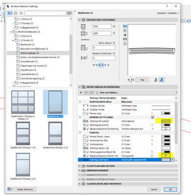

I've got a problem with the doors and windows in the circular slanted walls.
When I place them there, the hatch pattern shows through them in plans as if they didn't form the holes in these circular slanted walls:
Could you please tell me what should I do to remove this hatch pattern from underneath the doors and windows, and make them look like in ordinary vertical walls?:

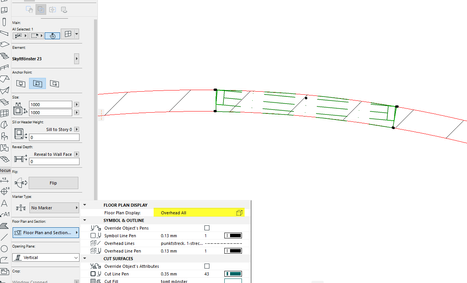

Check that you don't have selected 'Overhead all' in 'floor plan display'.

Check in the 'Settings dialogue -> Plan and section' that you don't have fills set up with a transparent background. Excuse my Swedish settings.

Thanks! No problem, mine is German) But it doesn't seem to work. As to the Floor Plan Display, it says: "Symbolic", and the hatch pattern still shows through:
And as to the settings for plan and section, I haven't found all that you have shown in your screenshot perhaps:
