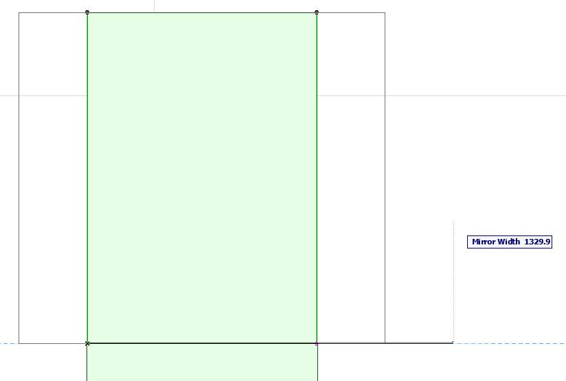

Hi, I am having a problem with dynamic hotspots working correctly with this specific object. I can't seem to work it out.
	HOTSPOT -mirror_width/2, 0.024, 1.1,HSID+1, mirror_width, 1+128      !base
	HSID = HSID+1
	HOTSPOT -1, 0, 0, HSID+1, mirror_width, 3         !reference
	HSID = HSID+1
	HOTSPOT mirror_width/2, 0.024, 1.1 ,HSID+1, mirror_width, 2      !moveable
I can't get the hotspot to move accurately with the dimension shown in the picture. I know that it's because it is using -mirror_width/2 which is changing but I do not know an alternative option which is what I'm after.

I don't currently have ArchiCad open to confirm, but I would try this:
HOTSPOT -mirror_width/2, 0.024, 1.1, HSID, mirror_width, 1+128: HSID = HSID+1  !base
HOTSPOT mirror_width/2, 0.024, 1.1 ,HSID, mirror_width, 2: HSID = HSID+1    !moveable
HOTSPOT 1, 0.024, 1.1, HSID, mirror_width, 3: HSID = HSID+1         !reference

It sadly behaves the same way as my original. Thanks for the reply.

In Your code - You are asking the Parameter mirror_width.
If You calculate within the sequence - archicad "gets puzzeld".
You dont have to calculate in the sequence!
You wrote: mirror_width/2
With /2 You get not working results on the asked parameter
Just try it without any calculation.

Try this:
2 parameters: mirror_width,mirror_widthper2
Parameters script: parameters mirror_width=mirror_widthper2*2
2d script:
HSID=1
HOTSPOT2 0, 0.024, HSID, mirror_widthper2, 1+128 ,mirror_width :HSID=HSID+1 !base
HOTSPOT2 mirror_widthper2, 0.024, HSID, mirror_widthper2, 2 ,mirror_width :HSID=HSID+1 !moveable
HOTSPOT2 -1, 0.024, HSID, mirror_widthper2, 3 ,mirror_width :HSID=HSID+1 !reference
HOTSPOT2 -mirror_widthper2, 0.024, HSID, mirror_widthper2, 2 ,mirror_width :HSID=HSID+1 !moveable
HOTSPOT2 1, 0.024, HSID, mirror_widthper2, 3 ,mirror_width :HSID=HSID+1 !reference
hotspot2 0,0
line2 mirror_width*.5,0,-mirror_width*.5,0
This part is fine if you just want to stretch the mirror with the hotspot.
But if you want to type a figure into the tracker then it won't work because you are still actually adjusting the half width while displaying the value of the full with on the hotspot.
But to get around that just add this to the parameter script instead of what you had.
if GLOB_MODPAR_NAME = "mirror_widthper2" then
	mirror_width = mirror_widthper2*2
	PARAMETERS mirror_width = mirror_width
endif
if GLOB_MODPAR_NAME = "mirror_width" then
	mirror_widthper2 = mirror_width*0.5
	PARAMETERS mirror_widthper2 = mirror_widthper2
endif
This way whether you adjust the half width or the full width one will adjust the other.
