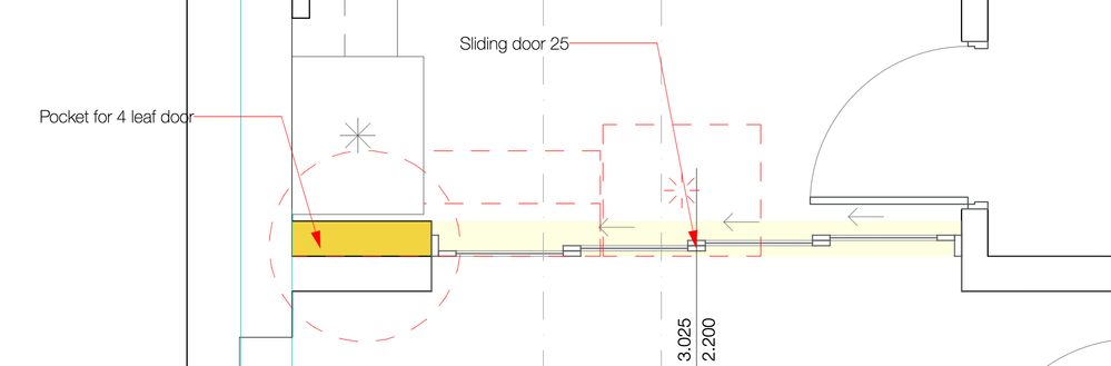

Hi Everyone,
I was wondering if anyone knows how or from where to include a pocket door with multiple leaf, or how to solve this issue?
I would appreciate a lot if anyone can help me.

Hello Ian_Forbes_Arch itect,
In this case, I make my own door from a plan view and with slabs. Before saving my slabs as a door, I add a last one corresponding to the hole in the wall corresponding to my opening: to do this, all you have to do is give it the element id "wallhole". The door will not be openable but it will have a correct 3D representation and its 2D representation will be customizable via the 2D Symbol tab of the door object in question.
