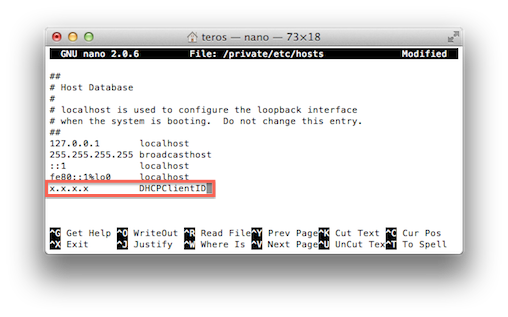

On Mac if borrowing still does not work some additional settings can be required (e.g. mainly in mixed, Mac+PC environment) . You may have to bind the IP address of the license server to its name in the hosts file of the client computer. An administrator user can do this following these steps:
  • Open Terminal
  • Use the following command to edit the hosts file: sudo nano /private/etc/hosts
  • Enter your administrator password. Note nothing will be visible on the screen.
  • Navigate to a blank row at the bottom of the host file and enter the new mapping here. On the screenshot x.x.x.x is the IP address what you have reserved for the license server at the DHCP settings of the router, and DHCPClientID is the DHCP Client ID of the license server.
  • Press ctrl+o to save the file. Do not change its name.
wp-content_uploads_archicadwiki_codemeter-networksettingsforlicenseborrowing--hosts01.png
  • Restart the computer and test borrowing.
