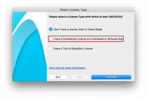

When you  start ARCHICAD 22 after successful installation without signing into GRAPHISOFT ID, a dialogue window appears with different license options on how to start ARCHICAD:

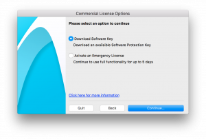

  • If you have already acquired a Commercial license on Hardware or Software Key, select the second option.
  • Select Download Software Key.
  • ARCHICAD will download the license from the License pool after verifying your GRAPHISOFT ID (GSID) Information:

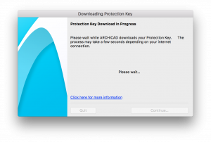

    Downloading Protection Key
  • After successful authentication, ARCHICAD downloads automatically the available protection key from License Pool.
    NOTE:The license download may take a few minutes, please be patient.

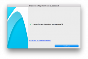

Protection Key Download Successful
  • When the download is successfully completed, you should be able to use ARCHICAD in full mode afterwards.

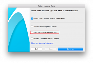

If you previously logged-in with your GRAPHISOFT ID in ARCHICAD 22, the dialogue window appears slightly different as opposed to the one in workflow 1. However, should you decide to open ARCHICAD with Commercial License, you need to select Start License Manager Tool (LMT) option.

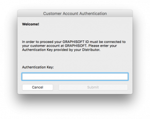

      • If you are doing this for the first time, after signing-in with your GSID, a window pops up asking you for an authentication key. Your reseller supplies this authentication key to you.

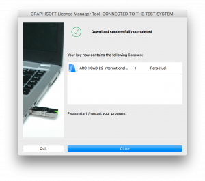

  • Click Download, you would get a notification once the download is completed.
  • When the download is successfully completed, subsequently you should be able to use ARCHICAD full mode.
