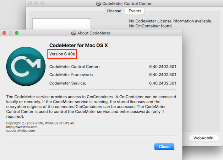

wp-content_uploads_2016_06_Info_18x18.png CodeMeter driver version can be checked:
  • macOS: Codemeter Control Center: CodeMeter menu/About CodeMeter
  • Windows: CodeMeter Control Center: Help menu/About
