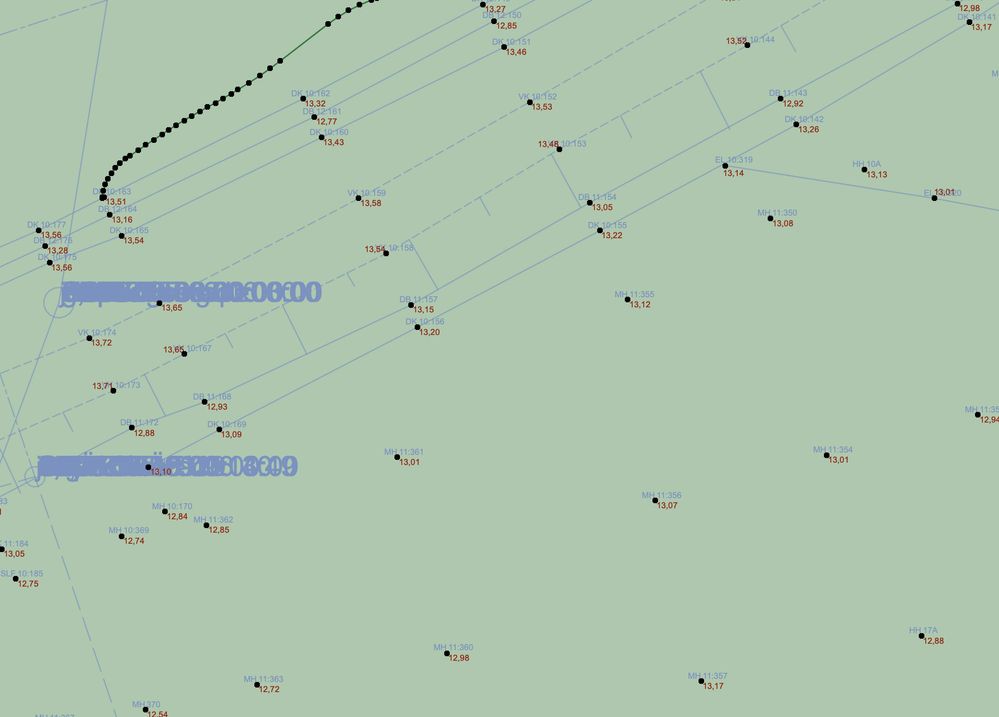

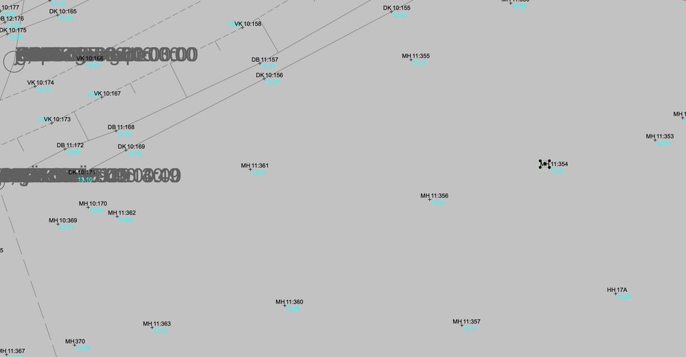

Hi I got 2D DWG with information of points and curves highs information.
My process was like :
1. Make a MESH
2. Use magic wand and make points and curve high on mesh ( very time consuming )
3. Manually writing highs ( tedius work )
My question is is there any faster or better solution 😉 ?
Take into consideration that I got just 2D DWG. I didn't get any excel points etc.
I would be very grateful for any faster and hack for it because I'm doing this quite often.
Thanks 😉

Hi this is not exactly my point of this question.
I'm looking for how can I do it faster or easier way.
Your links is exactly how I'm working now and I'm little bit tired of this process.
I would like to find some trick or something

Hello @Vojtech Slavik,
@Emoke Csikos is right, the best way to model a mesh is how you already do because we are able to generate a mesh from a xyz file but it goes to countless dots. These dots will have to be modified later
(as part of your project) one by one as you create them today. The ideal is therefore to model the points you need, or to add points as you need them. In the preliminary phase, you can, for example, content yourself with the points around the building and the outline of the plot and then add points according to your design.
