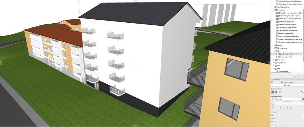

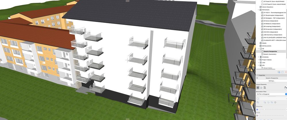

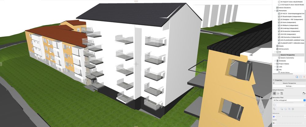

Hi I have problem with 3D view.
It start glitching graphic when I change renovation tool
- I know that my colleague started this project with real word coordination.
- I moved back to 0.0.0 because Archicad have problem working far from 0
After moved close to 0 Glitching start whan I change renovation filter
I'm using renovation filter for showing more alternatives
Can I restart / reset coordination in 3D view or do you know what it can be problem ?

I figured it out. 🙂
This problem happened because I left one building so far from 0.0.0 After deleting this building this problem disappeared

You should be able to edit posts, but I think there is an issue with Safari not allowing it (on Mac at least).
You can't delete post (but please don't even if you could), as this post and your solution is good advice for other members.
Thanks Barry I just felt silly because i figured out this issue few seconds after this post 😇
