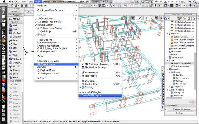

I'm new to archicad and I don't know what happened, the 3D view suddenly changes to wireframe even though i set it to shading. Before, it didn't have any problem and it showed a shaded view. Then in the 3D view I hid all the walls. I went back to section view, and show all layers. then I went back to 3D view, and it turned like this. I can't seem to change it. Can anyone help? Thanks in advance.

Did you accidentally make you layers wire frame when you turned them all on?
This can be controlled in the layer settings dialogue.

actually yes maybe it has something to do with the layers, i may accidentally have touched some icons i didn't know. I set the layer set back to draft, and it turned back to shaded mode. Phew. Thanks!
