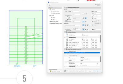

Having issues with the stair tool in AC25 - after designing the stair (which often times is not matching up to my desires) and I need to make changes, it allows the changes on screen but after I close out it doesn't apply. The settings revert to what it was before editing. I have to always redraw the stair.
What am I missing?

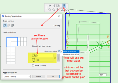

As for the treads starting at the landing.
Set the riser offset to zero (one may be greyed out as it will be the other landing corner).
If you have it as a 'fixed' offset, it will use that figure and stair will change automatically.
If it is set to 'minimum' then the stair nodes for the flight length will need to be stretched as they will be more than the minimum.
You have to stretch the flight back to the minimum.

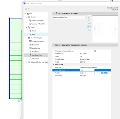

Hey Barry, thanks for your response. I restarted AC and the settings began to work. I have done the screen grab regardless. I noticed as well there is a warning symbol beside the stair setting (not sure why) and also I am unable to get my threads to stop and start at the landing without the landing extending out a bit (as shown).

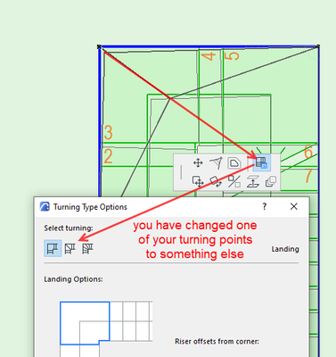

The yellow warning explains why your stair is not changing when you edit it.
There is a similar post here that explains it but is it about railings.
https://community.graphisoft.com/t5/Design-forum/AC-22-Railing-Tool/m-p/271417
The yellow warning means you have edited an individual part of the stair - in this case a turning.
Which is fine.
It just means that the settings you see for the whole stair, will no longer apply to the whole stair.
They may only affect part of the stair up to that now custom point.
You can reset with the button at the bottom of the settings but this will reset your stair to what it was before and the general settings should now apply to the whole stair again.
Otherwise you need to now 'Edit' each piece of the stair individually.
I hope that makes some kind of sense.
