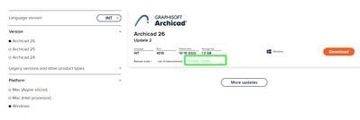

'This is actually a known bug in AC26, DEF-10919. The fix is already done and will be released with AC26 Update 4. Until then, please avoid using this option'.
Till today we are in update 2, waiting for update 3.....
Archicad 25-26. Windows 11. Intel Xeon 2680x2,64 GB RAM, Nvidia 3080Ti. 2 Monitors.
There has been an update from GS since further up this post that they are fixing it in the next update, update 3.
