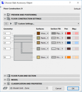

The Floor Construction object can model layered floors.
Use the Floor Construction Settings, Section, and Model panels to achieve the desired effect.

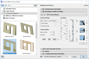

With the Wall Accessories command, you can place a variety of objects adding details to your walls. The Moldings and Panelings object model interior details on walls consisting of up to three selectable molding profiles, and optional paneling (wainscot and wall panels) between these moldings. The object's custom parameters can be set in the Choose Wall Accessory Object dialog box, on either the Custom Settings or the All Parameters panel. Parameters are grouped according to different criteria on the two panels.
In Custom Settings:
  • one for the General Settings, Geometry, and Custom Angles
In Parameters:
  • set Surfaces and 2D Representation

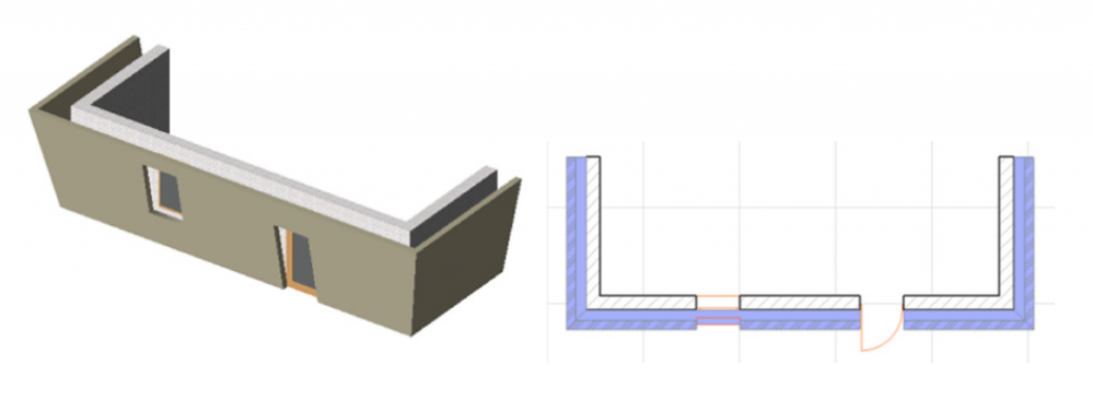

The Wall Framing object can be used to represent stud framing within walls. It handles the properly added studs at right-angle corners and incoming wall joints. At the windows and doors, it adds double studs, cripples, and jack studs as well as parametric headers. The top header plate is broken or extended to provide overlap at the joining walls.
The parameter list for 2D Representation includes an on/off checkbox for Show Framing Elevation. Switching this parameter On enables you to edit the 3D geometry on the Floor Plan.
Restrictions: Openings for Doors and Windows will have horizontal edges perpendicular to the original wall plane. These objects have their property script set up to provide LUMBER PACK calculation where the individual pieces are listed with their nominal cross-section sizes and their length is rounded up - if necessary - to the next inch. The list also gives an estimate on the overall board feet quantity.
