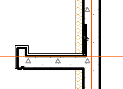

After SOE Subtract, I want to make the thick line attached to the insulation material as a thin line
LeeJaeYoung
After SOE Subtract, I want to make the thick line attached to the insulation material as a thin line among the two thick wires. Is it possible?
Left is GDL.
I am trying to express liquid waterproofing with GDL on the wall.
I can't adjust the thickness of the line

Hello @LeeJaeYoung,
The thick strokes seem to match the outlines of the right wall. I don't think it's possible to make one of the thick wall outlines into a thinner stroke singular.
