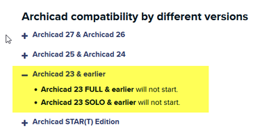

2023-11-15 03:31 AM
You will find that Archicad 23 does not run on Sonoma.
