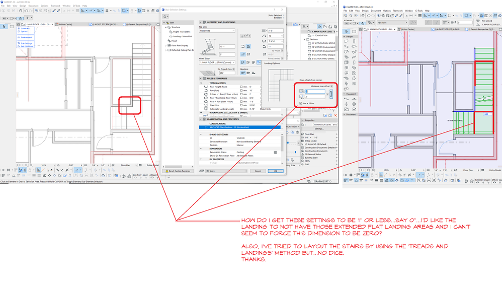

trying to create a simple "L-shaped" stair and having trouble with the landing settings from the point of the treads edges. (see attached)

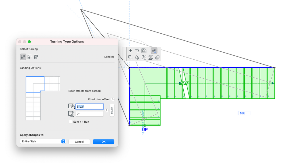

Patrick M
try clicking the stair ref line on the landing node, select the "turning type options" on the pet palette, and redefine there for the "entire stair" (screen shot attached).
I'm not exactly sure why that works and the stair settings done, and sometimes its the opposite... and then again, sometimes neither works and you ahve to set it in the stair settings, eye drop the placed stair and place a new stair completely

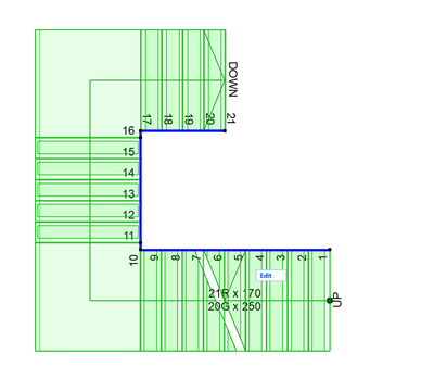

ryejuan
do you intend to have something like this?

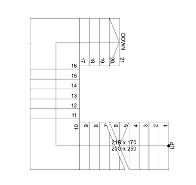

AllanP
or is this what you want?

rob2218
Allan,
that’s exactly what I’m in need of. How did you make that work?

AllanP
Archicad almost works, but you have to manually edit the width of the stair to get the zero landing.
This is a common situation on most stairs for L-shape and U-shape landings in Volume Detached Housing in Oz.
