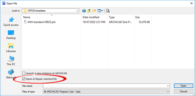

Start Archicad without opening the file.
Then go through the FILE > OPEN menu to manually search for the file.
Use the 'Open & Repair' option to see if that has any effect.
Might be bad objects in 3D.
It might not do anything, but is worth a try.
Excellent, that seemed to work. Thanks!
