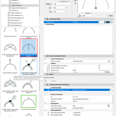

Hi ! I Cant find sockets in library, there are some but looks like they all are unfinished for me
I need symbols like those one on picture.
Also I can't customize the ones AC have, What I'm missing?
Can I somehow customize existing ones under my needs ?
P.S. for example the "red" one is good but lacks that top line that indicates number of sockets in a socket group
Or that "green" one have that top line but it indicates the socket that doesn't sits inside a wall
in other words need to have ability customize, by the way why not have customizable one or two symbols instead of having dozens of different variations of those ?

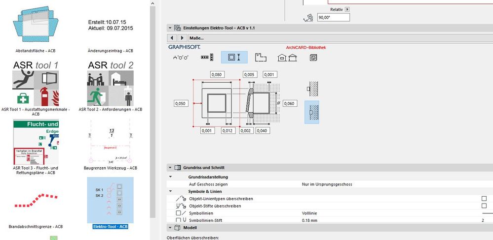

Frank Harper
The German Subscription Service ArchicaRd offers smart gdl sockets and light switches to add into the library.
