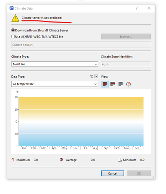

Hi! I've been trying to access the server of Strusoft from AC26 and AC25 to download the local data of Lisbon, but the climate data window prompts the following message (this message appears on the other computers of the office too):
Does anyone know how what might be happening? Thanks!

Thanks for bringing this issue to our attention. Our hosting provider is changing the underlying network architecture forcing us to move to their new solution. The fix is planned to be rolling out for Archicad 25 and 26 in updates and in the Archicad 27 release as well.

‎2023-04-06 12:41 PM - edited ‎2023-04-06 12:42 PM
You're right, I can experience the same.
This issue was fixed in Archicad 26 Update 3, however, if Update 2 had been installed previously, the fix doesn't apply, a manual adjustment is needed in the Registry Editor (Windows) or Prefs Editor (macOS) in order to connect to the proper Climate Data Server address.
The developers are currently working on a solution for the next update that would carry out the fix with the installer, so no manual adjustment would be required.
Please use the following workaround in the meantime:
Windows
- Close Archicad if it is running.
- Open the Registry Editor application and navigate to this directory: Computer\HKEY_CURRENT_USER\SOFTWARE\GRAPHISOFT\ARCHICAD\Archicad 26.0.0 INT R1\EnergyEvaluation *
- Change the value for the "StrusoftWeatherDataServer" line (by double-clicking on its name) to "https://climate-server.bim.energy/" (without the quotation marks)
*If you use a different language version of Archicad, you have to locate the EnergyEvaluation directory for your localized Archicad, e.g. ...\Archicad 26.0.0 UKI R1\...
macOS
- Open the Prefs Editor application (or any other app that can handle .plist files) and select your used Archicad version from the list of applications, e.g. com.graphisoft.AC-ARM 26.0.0 INT v1.
- In the popup window search/filter for the EnergyEvaluation directory and inside that find the "StrusoftWeatherDataServer" line
- Change the value of the mentioned line by clicking into the column on the right to "https://climate-server.bim.energy/" (without the quotation marks)
Kind Regards,
Oleksandra Vakariuk

I ended up taking some .epw files from this site https://energyplus.net/weather

‎2023-04-03 01:27 PM
Hi, we have updated our AC, and the problem remains. What else can we do?

‎2023-04-06 09:14 PM
Hi Oleksandra,
thank you very much for your post. I am running AC26 International 5003 on macOS Ventura (13.2.1) on Apple Silicon. I applied your changes exactly. The result was a very long spinning BeachBall and, after about 2min, the following floating palette:
It appears as if this fix is still not working.
