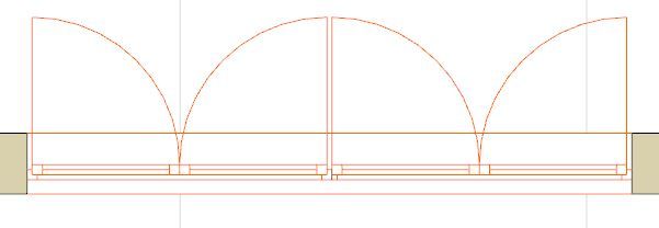

Thank Barry,
I have been requested a complex quadruple window also upper transom. I can't find any in Archicad Library 18 to suite. hence I decided to use 2 double windows and let them overlap at the frames, that is pretty good on the elevation. Unfortunately, they are separated in the schedule.
PK.
There is a horizontal multi-sash window in 18 but it doesn't seem to have a transom.
So you are back to square one adding a separate window above.
There is a 4 sash sliding window and that does have a transom which will be fine if you have a sliding window.
That is pretty help , thanks. In spite of floor plan graphics indicate as a sliding window, this is not what i expected (see attachment). I will play with 2D for that.
PK.
