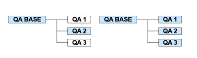

An identical sub-set of rules are often used for multiple combinations.
Combinations is what ultimately determines the view specific graphical reproduction of the model. Multiple views often has the same graphic base but with variations "on top" depending on different situations. For example QA processes which have a base 2D/3D representation of the model to which different aspects are highlighted across different views.
Currently combinations are nothing more then a list of rules. This means that if a set of rules is to be used for multiple combinations then the rules has to be added to each combination’s list and if any change is done for the base view it has to be done for each combination.
Instead a combination should be able to inherit the rules from another combination.
In addition to the efficiency gain this would also lend it self to organisation and open up to a interesting new approach where a tree structure is used as a interface for controlling which rules are applied. This would be useful when working actively in the modell.
