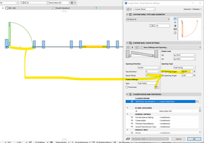

Hi All--
Been searching everywhere and reading all the related posts I can, but still no answers - trying to understand why only one door in my curtain wall is showing as open. When I created the wall both doors were showing the swings, but for some reason one shows as closed now in plan and I can not get it to show open (Opening Lines 2D Override is activated (screenshot attached) - but not affecting the door in plan view). Settings the same for both doors - but only one showing swing now. Cut plans are obviously not the issue. Please see the screenshot attached with red highlight around the two door panels. Any help greatly appreciated.

So, there are lots of issues with the Curtain Wall geometry. I would probably just start from scratch and redo the whole thing because some of the rogue Frames can be deleted only for the 2nd or 3rd try. For example, I go to Edit mode in Elevation, select and delete all Panels, then select and delete all Frames, at which point only the boundary should be left. Instead, this is what I have: towards the top right, there is still a Panel, and in the bottom left there are still two Frames I could not delete:
This is why I suggest redoing it from scratch because there are just all these rogue Frames and Panels in the Curtain Wall's data structure, so it is probably best to throw it away and start anew.
Then, when the Curtain Wall is modeled correctly, hopefully, there will not be a problem with the display of the CW Door swing in 2D. 

Hi
is 2D Opening Angle set to 90°?
BIM Manager at SIEBERT+TALAŠ
www.sieberttalas.com
Yes of course. The only setting different than the other CW Door is the Opening Type being set to Tilt-Turn Mirrored (so it opens RH instead of LH).
