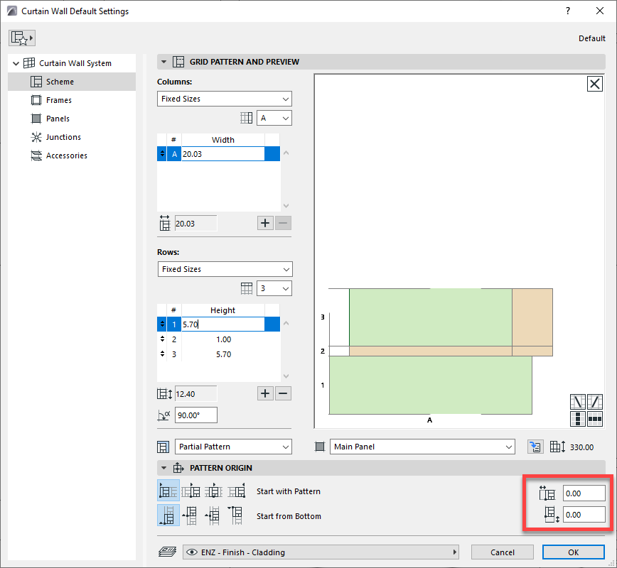

Hello,
When I make a curtain wall, the first mullion's boundary lines are not visible. Anyone know what's going on?
Thanks

1 ACCEPTED SOLUTION
Solution
I figured out the issue. All my curtain walls had an offset in the scheme's pattern origin by 1" creating an overlap of the mullions causing issues with the lines showing correctly.

kosta
Your settings, your screenshots, in other words more info.
sometimes I have strange behavior with curtain walls when they are generated on path by wand tool.

Thank you for reporting back with the solution, this can be useful for others in the future.
If I understood you right, this is the field (the horizontal Offset field) that caused the Floor Plan Display issue:
