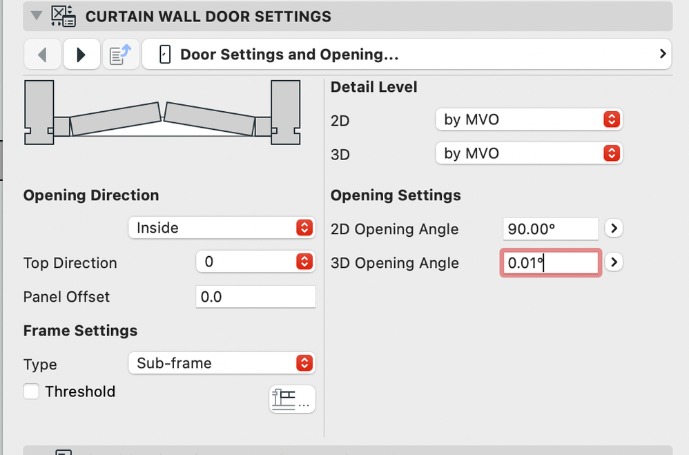

Unfortunately some of default Archicad doors are scripted without gap between panels and if they are made from the same material with the same surface, then line between them is gone on elevation.
Work around is to add 0.01º 3D opening angle and that will show the line. Other ways are: to model your own custom panel with gap or script the door in GDL

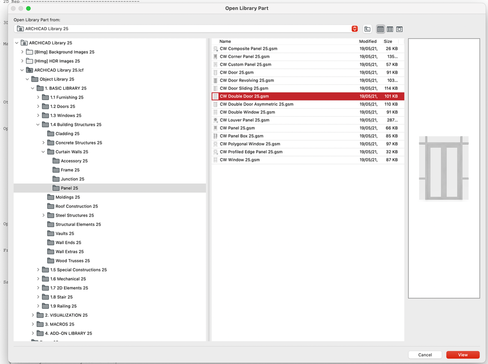

I guess you might like a bit more permanent solution than drawing lines in schedule and on elevations. So if you are brave enough to open GDL CW panels, here is what will make this line showing in 3D, 2D and in schedules without changing 3D opening angle
1. In Menu File / Library and Objects / Open Object. from Archicad Library 25 or whatever version you using in this case CW Double Door 25.gsm
2. Open 3D script and go to line 545. there is original addx sash_x add behind -0.001 that will offset panels and live gap between them
3. Save this object with different name in Embedded library and replace original with this new one
Your door should have now permanent gap between panels
