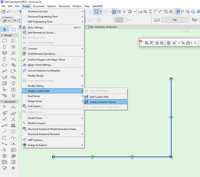

I wonder if there is a way to clean up the corner of a Curtainwall, like the two options below. Or will a custom frame do that? But then what should the custom frame look like?
I want the corner to present like any of these:

So long as the 2 frames touch ...
I think you can also change the frame to a corner frame in the settings, but I don't use curtain walls all that much so I'm not 100% sure.

No such function in AC26.  And I just want the glass (or panel) to join at the corner. Thanks for your input. My curtain wall is one object and not split as you suggest. See the image I posted...
That command is definitely in 26 - you may need to check your menus in the Work Environment.
You may not be using a standard WE, in which case you will need to add the command or switch to a standard WE.
I am not a curtain wall expert.
It seems you can have a common frame at the corner (you can even make the frame invisible).
But it seems the panel can not mitre.
Unless someone can show us how to do it.
I am assuming it is a butt-glazed connection you are after?
