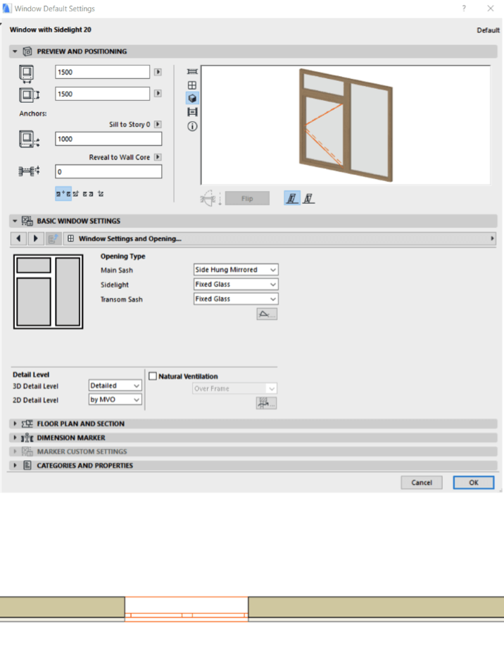

Start with a Default Window
Select a default window object, set the desired settings and place it on a wall…
Edit the Window Object
1., Select the window in the plan view and open it by pressing CTRL/CMD+SHIFT+O.
2., Save as a new window object in the embedded library before start the editing.

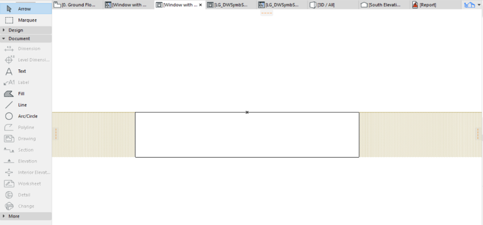

Outline for 2D Representation
1., Open plan view set the MVO to Simple 1 and using lines draw the outline of the window. Select the lines and press CTRL/CMD+C to copy.
2., Switch object window and click on the button next to 2D Symbol.
Sketching 2D Representations

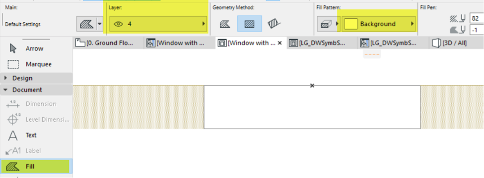

In the 2D Symbol window paste the lines copied in the previous step, use the line tool and fill tool to draw the 2D representation. As it is required to work based on MVO selection draw each representation in separate layers. Ex. Simple 2 in layer 1, Middle 1 in layer 2, Detailed in layer 3 and common elements in layer 4
Hotspots shall be added as well.
Add a Background fill to layer 4. This will cover the wall area where there is window.

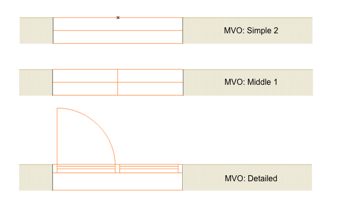

Add the lines for Simple 2 2D representation:
1., Window section lines to be in layer 1 that will be displayed when MVO Simple 2 is selected and
2., Wall section lines to be in layer 4 that will be displayed when MVO Simple 2 or Middle 1 or Detailed is selected.
1. Add the window section lines for Middle 1 and Detailed as well (layer 2 and layer 3 respectively) and
2. place them one on top of the other.

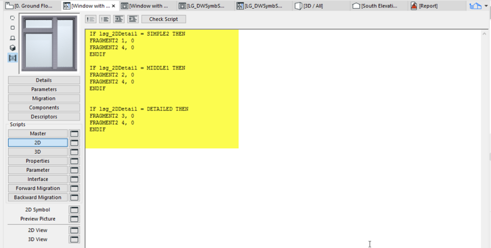

Add 2D Script to Call the 2D Representations
Switch to object interface and click on 2D button to open 2D script add the highlighted script.
2D Script Explanation
IF lsg_2DDetail = SIMPLE2 THEN
FRAGMENT2 1, 0
FRAGMENT2 4, 0
ENDIF
IF lsg_2DDetail = MIDDLE1 THEN
FRAGMENT2 2, 0
FRAGMENT2 4, 0
ENDIF
IF lsg_2DDetail = DETAILED THEN
FRAGMENT2 3, 0
FRAGMENT2 4, 0
ENDIF
Conditional statement IF THEN ENDIF is used to check the MVO option.
FRAGMENT2 statement is used to call the layer:
  • if the user select Simple 2 in MVO then display the content of layer 1 and 4
  • if the user select Middle 1 in MVO then display the content of layer 2 and 4
  • if the user select Detailed in MVO then display the content of layer 3 and 4
