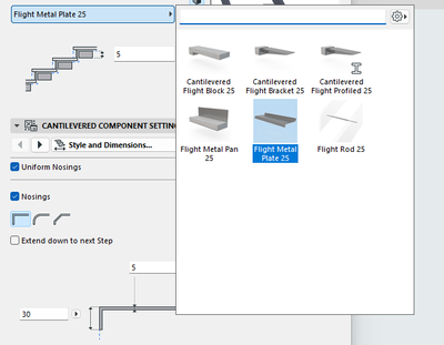

Hello, I was wondering, can I create a custom stair flight? The list of existing flights is given below:

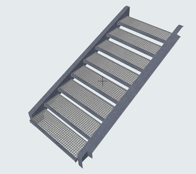

I'd like to have the steps this way:
I have constructed it with morph. What's the best way to turn it into the step of the stair? I tried it as a Flight Finish - Tread, but it's not appearing.

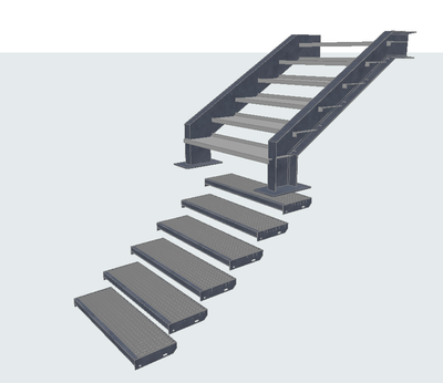

From memory, when you save the morph as a tread, there is something about setting the origin location for when it is used as a tread.
It looks good, you just have the wrong origin.

2023-01-05 10:02 AM
When I created a tread from that morph, it appeared this way:

2023-01-05 12:17 PM
Wohoo, that's it, thanks!
