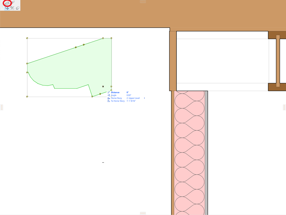

Eave attached to side edge of sloping roofs
Daniel_He
Hi, I created eave for a side edge of sloping roofs as showed in 1st picture, the problem showed in red circle, so I made a section to change angle of eave up to 15° as same as roof pitch as showed in 2nd picture. Then the eave and roof edge was aligned, however new issue appeared as showed in red circle mark in 3rd picture, how shall I do to solve it

Perhaps you are trying to solve the wrong problem?
To make the design look correct the return edge needs to be horizontal. Therefore you need to add a triangular roof element along that edge that connects with the main roof
