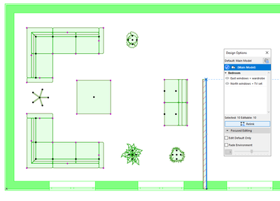

You can solve this easily by relocating the elements belonging to a deleted Design Option with the help of the “Design Option Missing” criterion, available in Find & Select and Graphic Overrides.
Resolve using Find & Select
In the Find & Select dialog:
  1. Add the “Design Option Missing” criterion and set its value to True
  1. Select the elements with the “+” button.
The selected Elements can then be assigned to the Main Model or a new Option using the Elements Settings dialog (under Classification and Properties → Design Option → Option Status).
Or you can relink them to a different Design Option via the Design Options palette (select the target Option and press Relink).
Relinking the Elements to the Main ModelRelinking the Elements to the Main Model

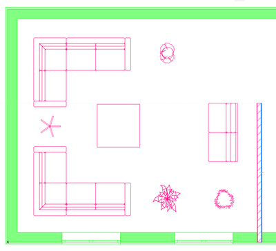

Visually differentiate using Graphic Overrides
You can also use a Graphic Override Rule to apply an overlay color to elements with “Missing” Design Option status.
  1. Create a new Rule and define the element Type.
  2. Add the “Design Option Missing” criterion and set its value to True.
  3. Create and activate a Graphic Override Combination.
In this Graphic Override Combination, elements with a “missing” Design Option status are colored pink and valid elements are greenIn this Graphic Override Combination, elements with a “missing” Design Option status are colored pink and valid elements are green
