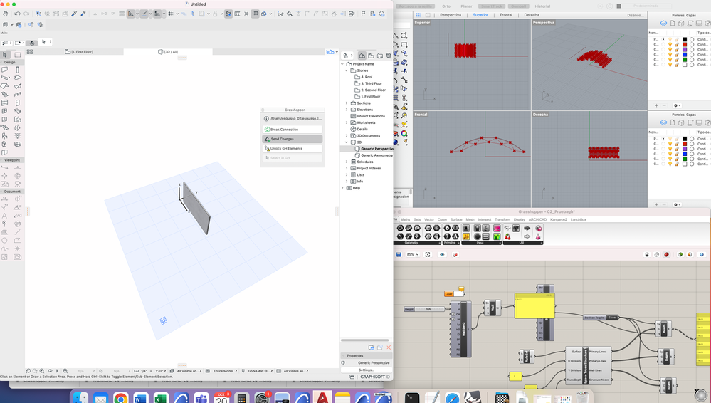

Does anyone know why this error happens on Mac?
What happens is that I need to use rhino-grasshopper and make the live connection with Archicad 25-26, I download and install the live connection plug-in and when doing something in grasshopper it is not reflected in Archicad, however, Archicad does recognize that there is a connection. I have already tried to test different versions and I have also installed the live connection plug in for each version they all have the same error.
In a post on this forum, I found that a possible solution was to modify the name of the file found inside the path /Users//Library/Preferences/) and rename it from:
com.mcneel.rhinoceros.7.plist to com.mcneel.rhinoceros.plist
But this didn’t work. Below are some images of what happens. I thank you in advance for your help.
Captura de Pantalla 2022-10-20 a la(s) 4.54.30 p. m..pngCaptura de Pantalla 2022-10-20 a la(s) 4.51.10 p. m..pngCaptura de Pantalla 2022-10-20 a la(s) 4.52.39 p. m..pngCaptura de Pantalla 2022-10-20 a la(s) 4.52.26 p. m..png
I used to experience this problem, but it got sorted with the latest update of the connection. Have you tried that? I am in MacOS Monterrey and using AC 26, not sure if being in Big Sur may be a factor on your issue.
Archicad 26 ARM, MacBook Pro M1 Max 64Gb, macOS Monterrey.
Yeah. I tried to install and uninstall different versions of Archicad (24,25,26), also I install and unstall the connection with rhino-grasshopper for rhino (7,6) depending on the connection that exists for each version as stipulated in Graphisoft but the error continues as seen in the images.
