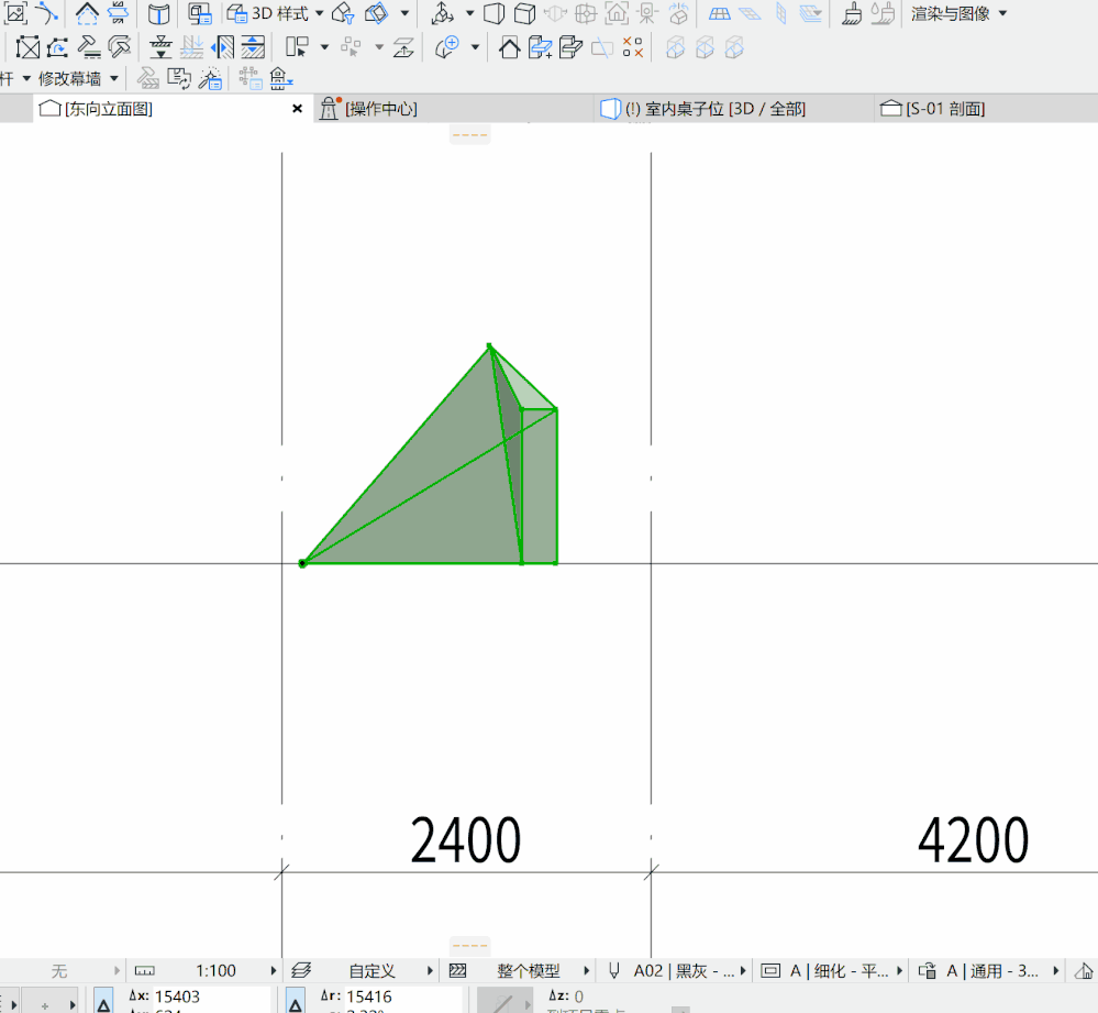

Hey guys , I found a problem. How can I mirror an Object and  a morph on Z axis? Thank you.

but I can't mirror morph in the elevation/section. When I use mirror and click in the elevation/section view, it always mirrored left and right, not up and down (Z axis)
Or only I can do is mirror it in the same elevation and rotate the new one 180° and move it up to the original one??

For objects it depends but for morph on the other hand you can go to 3d view and mirror from there or you can create an elevation/ section view then mirror from there. 😎

William Yan

ryejuan
surprisingly you can't mirror a morph you can only rotate and mirror it then bring back to the same location or your preferred axis point. 😐

William Yan
yeah, I can't make it. Can you show me a GIF or some op videos. I use mirror function, and want to drag a mirror line,  when I first click the view, they mirrored side by side.

ryejuan
This is the way you can do it a bit of a work around...

William Yan
OK, Thank you for your reply. So you can't mirror morph on z axis directly either, haha. I am balanced.😁
