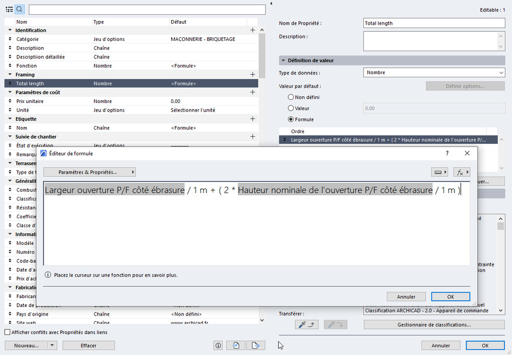

i use expressions properties, it works for 95% of cases

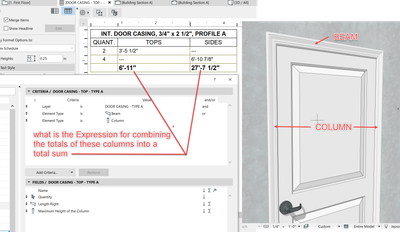

What is an expression for combining the total of columns or rows of an Interactive Schedule ?

to use expressions, you won't need to model framings using beams and columns, te property is :
door widh + 2w door height ,
i have a frensh version, so expression is in frensh in the screenshot,
* in the propertie manager, create a property called framing legth,
* set the data type on the right to " NUMBER"
* select formula and type a formula
* you have to divide the door H and L bu 1m to convert them to numbers,
* set classification disponibility to all,
that's it

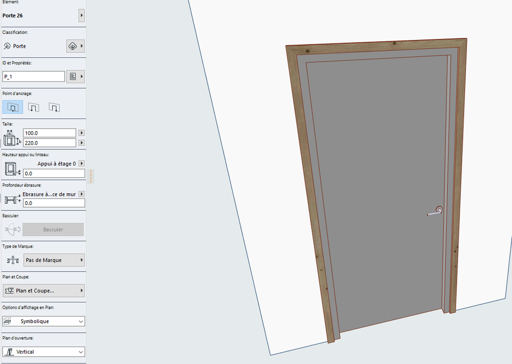

If you want to model frames, you can use this porperty :
in this time the fomula have multiple lines, it will show a value when contitionsare correctly marches,
if the element is a columns, it will show the column height,
if the element is a beam it will show the beam legth,
also, if you can sit IDS to the relevant door ID, so you can filter them in the schedule

Steve Jepson
That is perhaps a betterway to display what I am after in the Interactive Schedule.  But I am thinking of other Interactive Schedules as well.   Can an expression be written to simply combine the totals of rows and/or columns  into a total sum ?   I am guessing no.  There is nothing we can do to the Interactive Schedule sums. Expressions are only related to the data that can be reported in Interactive Schedules.   ?  Is that correct?
