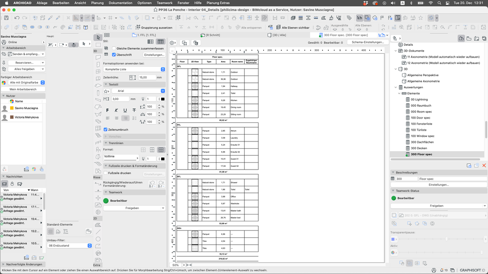

Hi there,
I am generating a floor finish schedule and I would Archicad to show me the belonging zone defined by the zone stamp where the element is positioned.
For example: if I have a wooden floor in the master bedroom, where I have already set up the zone stamp, I would like to see it in the schedule, automatically, in the field "zugehöriger raumname" - associated room name.
At the moment only one element works, I have tried to replicate that element, but it doesn't work everywhere which means that I have to manually type the "associate room name".
I would like to ask: what is the logic that automatically connects a slab element to a zone stamp, and what are the parameters/setting I have to control to display in the schedule the "associated room name".
It is always difficult to explain a technical issue, therefore, I hope I have provided enough information to understand the topic.

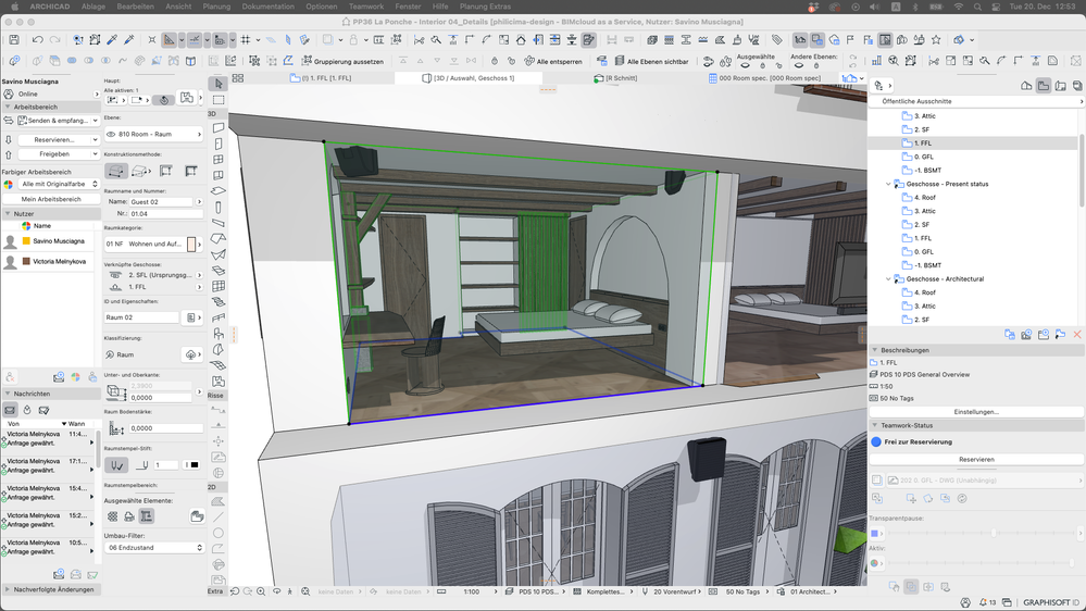

Hi Christophe,
I use the zone stamp tool - Raum-werkzeug - by drawing the perimeter of each area: bedroom, toilet, dining area, etc.
I have also made sure that each zone stamps are touching the floor and the ceiling of each room, as you can see on the screenshot.
Thank you.

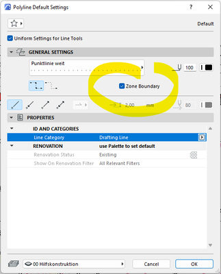

For model consistency it is important that you have propper connections between elements. Not only, but also for using automatic zone placement. It might be a bit more difficult to model in this way, but you really should do it. For example, if you need to divide two connected rooms into two Archicad zones, you shouldn't have just a wall gap between them, but you should use an empty opening for that.
If there is no way for you to get a closed zone perimeter than you should use a line or polyline on some otherwise hidden layer, with which you define the zone perimeter, but you need to assign that to this line, as shown here:
