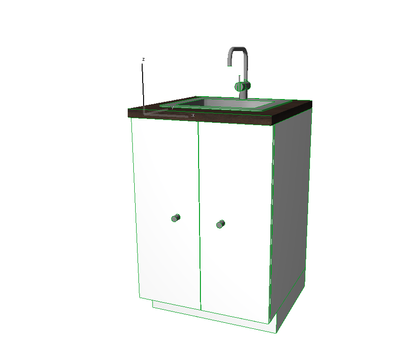

I would like to have a double doors to sink cabinets & standing cabinets yet Archicad 25 it only offers single doors with variable segment heights. Will they be introducing a 25 version of the 'Cabinet Base Double Door' & 'Cabinet tall double door' from v.24? Or is there a fix / setting to this ?
8 REPLIES 8
Mscott
Hi Julia,
Do you mean like this:

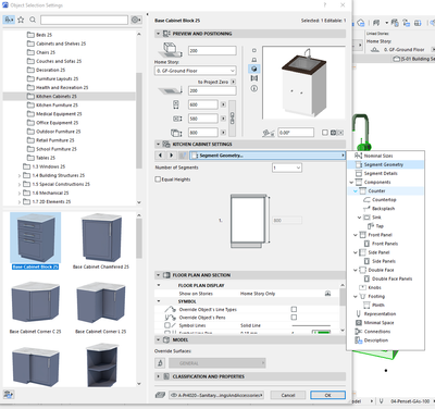

If so, to achieve this open the Base Cabinet Block 25 settings, set the segment geometry to 1:
Under segment details set the segment type to door, set the segment opening type to Double Hung.

Thanks to @Mscott for showing where these options are buried.  I'm just curious if anyone in the English speaking world (since we're looking at an English language library - USA in my case, but perhaps INT, UK, NZ, etc) uses the word "hung" when referring to cabinet doors??
In the US, a double hung window is a thing.  A double hung cabinet door is not a thing (to my knowledge).  It would be called a double door unit I think?
Look at this screenshot of USA options and comment on if the word "hung" matches any standard nomenclature.   I can imagine the 'top hung' would be an appliance bay perhaps?  I've never seen a bottom hinged kitchen cabinet.  The only bottom hinge thing I can imagine is for a 'secretary' - a fold down desk.
