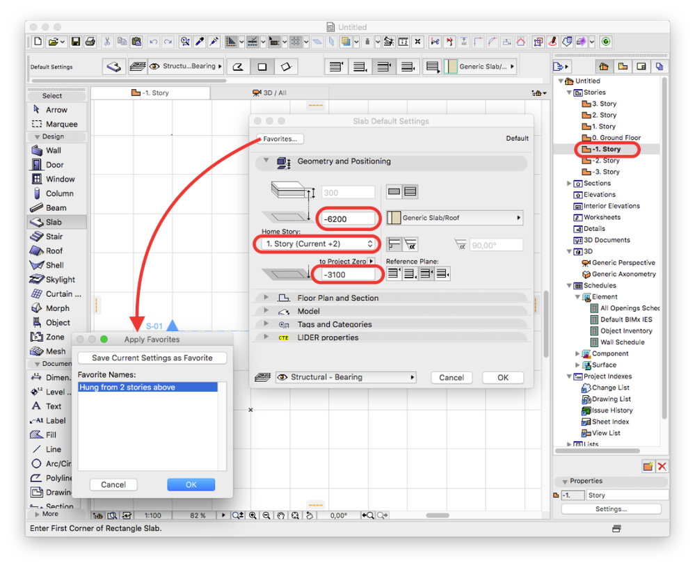

1. First, we have to allow ARCHICAD to apply Home Story parameter from Favorites: Open Favorite Preferences from the Favorites palette (click the arrow in the top right corner of the Favorites palette, and choose it from the Drop-down menu), and untick the Slab>Home Story checkbox.
2. Now, let’s say we want to place a slab on the height of -1. Story, but we want 1. Story to be it’s home story. So, we go to the -1. Story, and open the Slab Default Settings panel: We want the top of the slab to be on -3100 mm from Project 0, but we want it to be on the 1. Story, so we set the panel as in the picture (-6200 from Home Story). Then we save it as a Favorite (Hung from 2 stories above), and place it in the floor plan (just for reference)
3. Now, we want to place an element like this to a different floor, but we want it to be hung from 2 stories above again, so we will use the Favorite: We go to the Ground floor, and open the Slab Default Settings panel again. Now we set it to 0 mm offset from project zero, and set Ground floor to be it’s home story (we basically set it back to default) Now, we apply the previously saved Favorite to the default (we could also apply it to a placed slab), and it will put the Home story to two floors above (2. Story) based on the stored Offset (-6200 mm). You can see that the Home story changed, while the offset to project zero remained the same.
