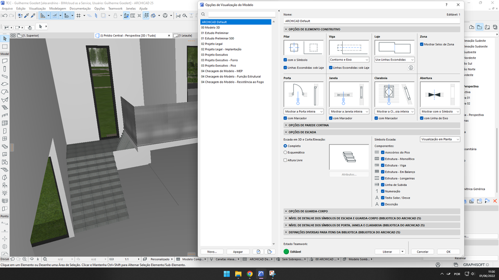

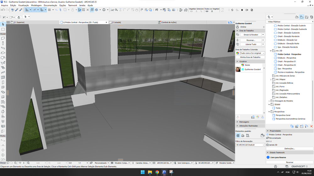

Hello, i'm having problems visualizing my 3D model for Stairs and Railing on my project.
They seem to be affected by some MVO status but everything is in default and turned off.
I have a base model for terrain with BIMcloud associeted buildings in different files, in the file of the building everything is fine in 3D.
Only in my main file I have this issue, and not only for associeted files, but if I try to make new stairs they also apear this way.
Thank you!

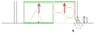

Yes you can.
You can add modifiers to the top of the skins so you can increase the height that way by stretching the individual skins.
Or you can set the 'height stretch' so that only a portion of the wall stretched as you adjust the overall height of the wall.
This way the angled portion at the bottom will remain unchanged.

Are you saying that you can't make a lower part that doesn't change even when the height of the wall changes like I wanted?
