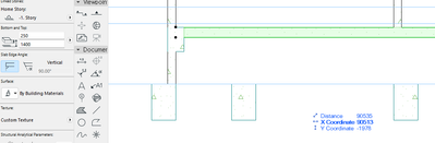

I want to show the beam as Hidden. Why does it vary with height?
LeeJaeYoung
1. section
   plan
2.section
plan
AC27 on window 11
1 REPLY 1
LeeJaeYoung
As I studied, I learned that I had to come within the cut height.
1000  => 3000
Changed from 1000 to 3000.
I found out that it only works if the slab is within the cut height.
