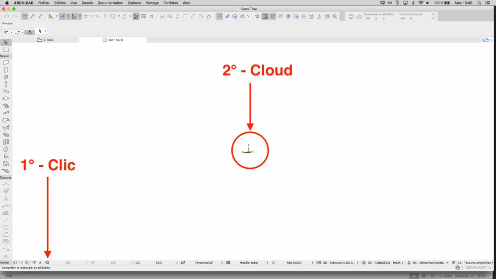

Hello @Mike96,
I tried to import your clouds after merging them.
The cloud seems to be far far away or there are some or one point(s) far from the cloud.
I always use Cloudcompare before importing e57 file into Archicad.
This is an essential step to obtain lighter clouds without loss of data, to assemble clouds, to clean up unnecessary points : furniture, trees, etc.
What I get into Cloudcompare (I have transformed scalar into RGB) :
What I get into Archicad :
The e57 file weighs only 25MB 😉 (link below)
