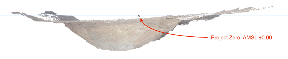

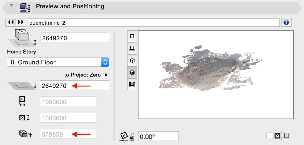

Depending on the object itself and its settings, it might happen that it is not visible on any of the floor plans right away. Locate it in 3D, you can see in the settings dialog where the bottom value is: the depth of the pit is 579.859 metres, the bottommost point of the pit is at AMSL +2649.270m and topmost point at 3229.129 metres, but it is floating above the Project Zero. When creating the final terrain, we need to make sure that the Level Dimensions show the right values.
2., Let’s position the point cloud vertically according to Project Zero. Whatever value we choose to offset the object with, the same amount has to be applied with the value of the opposite sign as a project altitude setting.
For example if our Project Zero should be around the top of the pit, e.g.: AMSL +3100, then we can simply drag it downwards in 3D or section by 3100 metres.

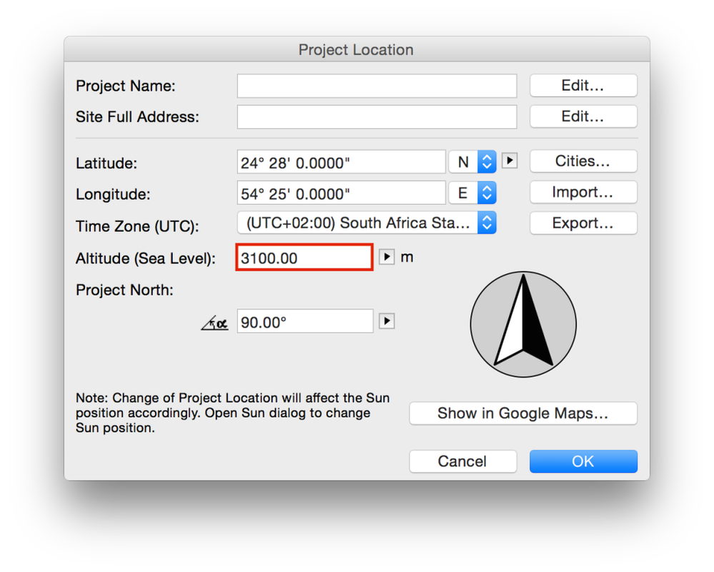

3., This will make the terrain and the Project Zero relation correct, but will affect the altitude values which we need to fix in the Project Location settings by adding the same amount as a plus (if you elevate the terrain upwards, the project altitude must be offset with a minus sign).
This way our Project Zero will be elevated to the desired altitude without the positioning being affected.

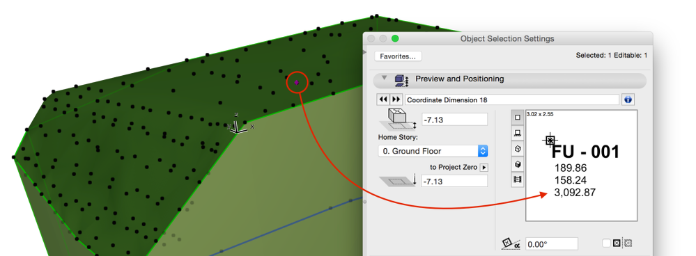

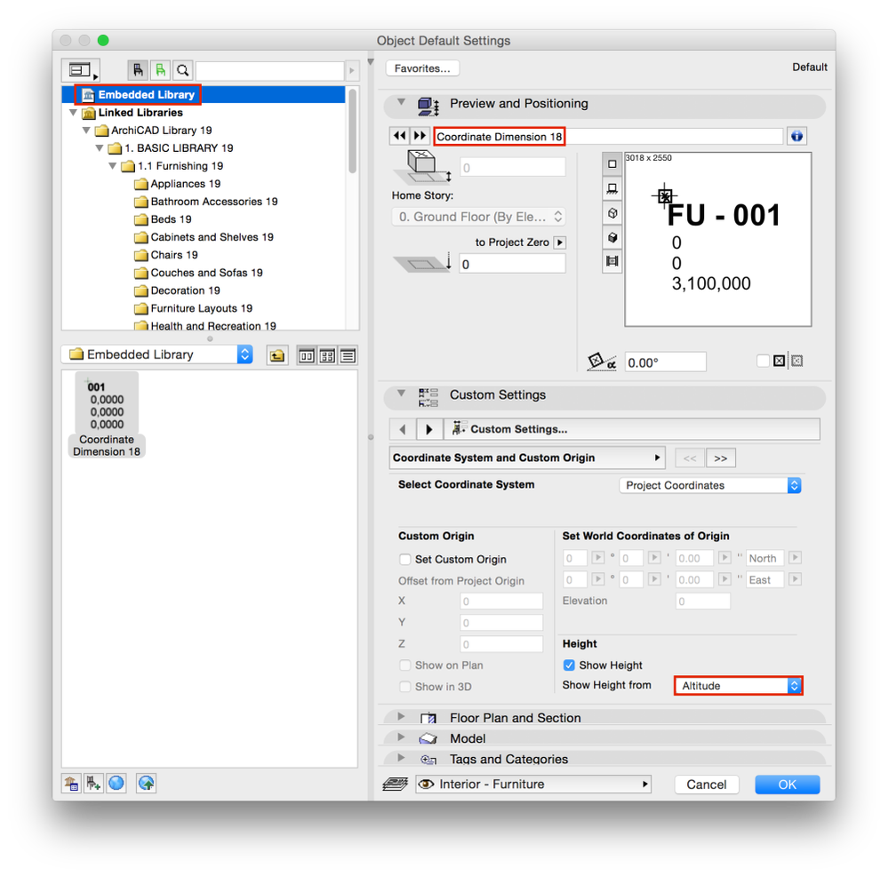

4., Let’s populate the terrain with the 3D instances of the Coordinate Object. Only these can adapt to the 3D faces of any element, the regular Level Dimensioning tool will not work as it can only be gravitated to specific elements. In order to be able to list the coordinates, you need to use the Coordinate Dimension object.
If you change its Show Height from value to Altitude you can actually check the vertical/altitude values once the objects are placed.
5., Place it to areas what you want to model. You may use the Marquee selection or 3D Cutaways to reduce the area in 3D. Place as many coordinates as needed, the more you place the detailed your model will be later. Depending on the size of the area this might take a while easily ending up in 100+ coordinates.

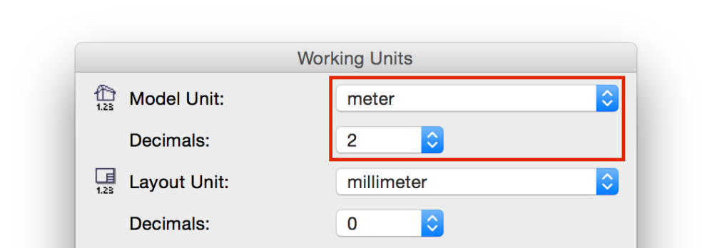

6., With such large models it is recommended to change the working units to meter with 2 decimals, so the schedules will be listed in those units. Go to Options/Project Preferences/Working Units….

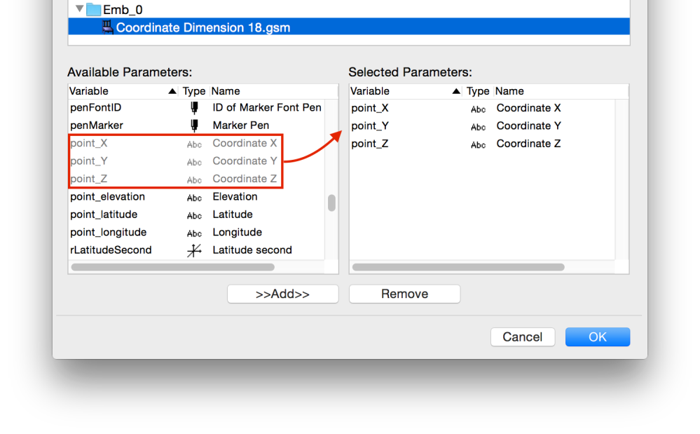

7., Create a new element schedule, choose Objects as criteria and add the Object Parameters into the Fields panel. Look for the embedded object and add the three Point parameters.

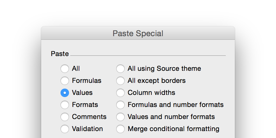

10., We only need one column in Excel, but deleting the first columns will result in an error in the formula, so we need to make the results static. Select and use Copy on the result column.
11., Select the column next to it and use Paste Special with the Values option.
The first three columns can be deleted now and you can save the file as .txt (Tab Delimited Text). Excel will include quotes around the column values if they contain commas when files are saved, which again will need some fixing in a text editor like Notepad. If the units were set to meters then only the dots will be included. (Commas come from the system settings of your computer on both Windows and Mac for digit grouping.)

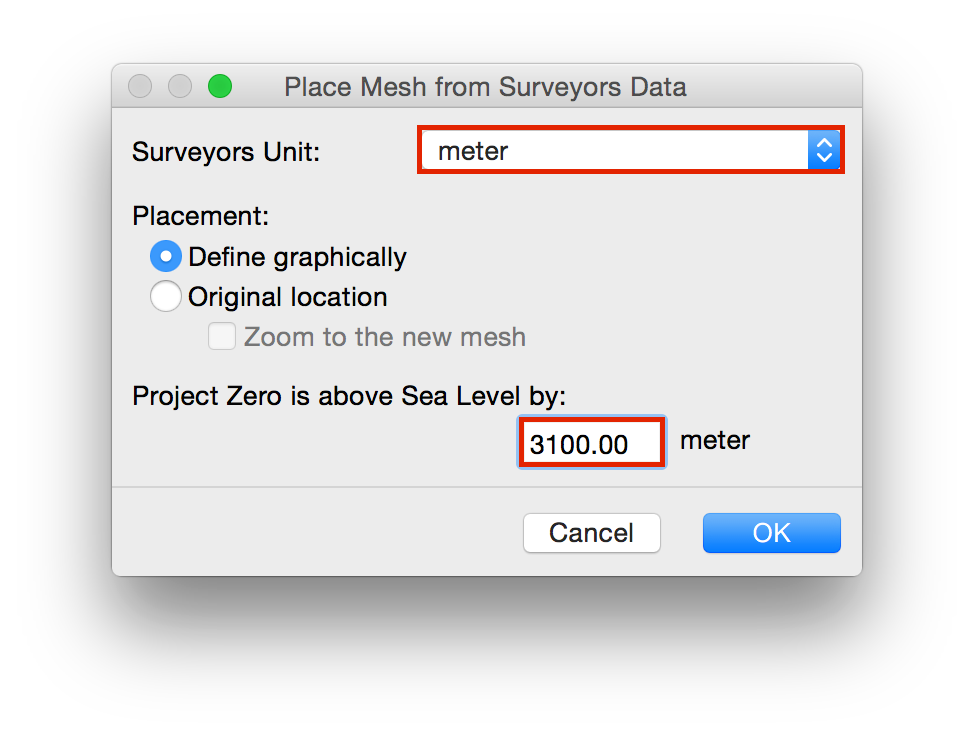

12., Use File/Interoperability/Place Mesh from Surveyors Data… in Archicad and browse for the text file. Make sure that the units are set to the same as what you used when placing the coordinate objects and define the elevation of Project Zero. This has to be the same as what we set in the file for the point cloud import and what we wanted in the first place.
This will only affect the positioning of the mesh compared to Project Zero, but will not change the Altitude value in the Project Location settings. That one will have to be set manually once the mesh is imported. After that you can try placing Coordinate Objects again to validate the altitudes to AMSL in 3D.

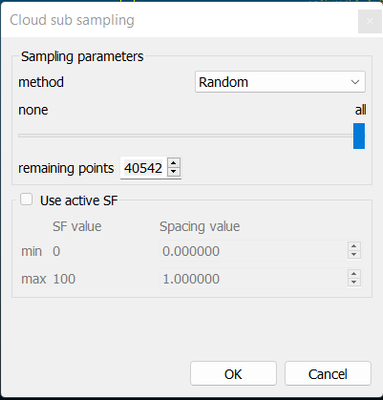

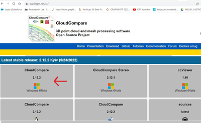

I think that a better way to use is open the Point Cloud on "Cloud Compare" to reduce the point cloud. edit---->Sub Sampling (on Cloud Compare)
Download for free from: https://www.danielgm.net/cc/

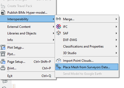

After that open Archicad en use Interoperability ---->  Place Mesh from Surveyors Data
And you have your "Reduced point cloud" on your Archicad like as a mesh 😉
