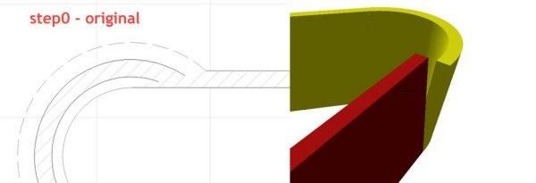

The connection of two Walls and their Fills on the Floor Plan does not match your needs. The intersection depends on the Reference Lines of the Walls (turn on View menu/On-Screen View Options/'Walls & Beams Reference Lines' option), on the geometry method of the Wall, on Wall Priorties and on many other object parameters. In our example we create an intersection of straight and slanted walls:
Step 0: Straight and Slanted Walls
This is the original situation. As you can see, the intersection on the floor plan and in 3D is different.

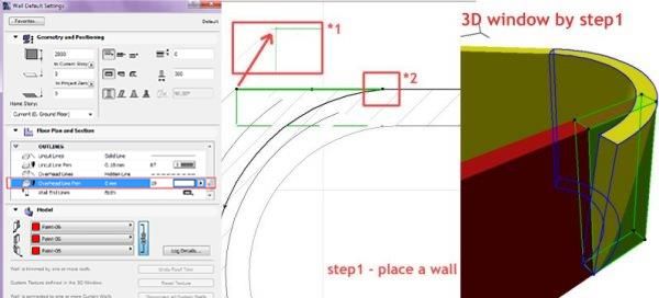

Step 1: Create an additional Wall
Place an additional wall with start and endpoints as you see on the below image.
wp-content_uploads_2016_06_Info_18x18.png NOTE: the wall parameters needs to be set, so you will not see the overhead line pen, that is, the end wall outline in 2D.

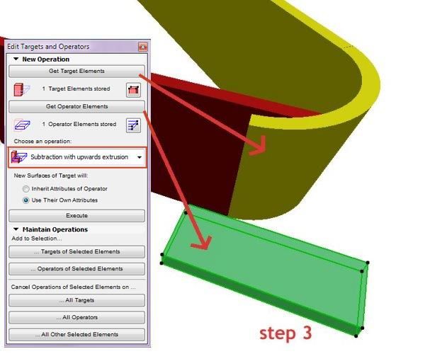

Step 2: Solid Element Operation
With Solid Element Operation (SEO: Design/ Solid Element Operation) enter the following settings and press Execute.
Step 3: Repeat Solid Element Operation

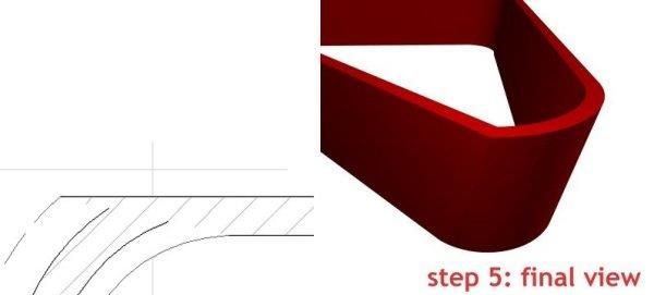

Step 5: See the result in 2D and 3D
The intersection in 2D and in 3D. ( with additional lines you can make the 2D view look better.)
