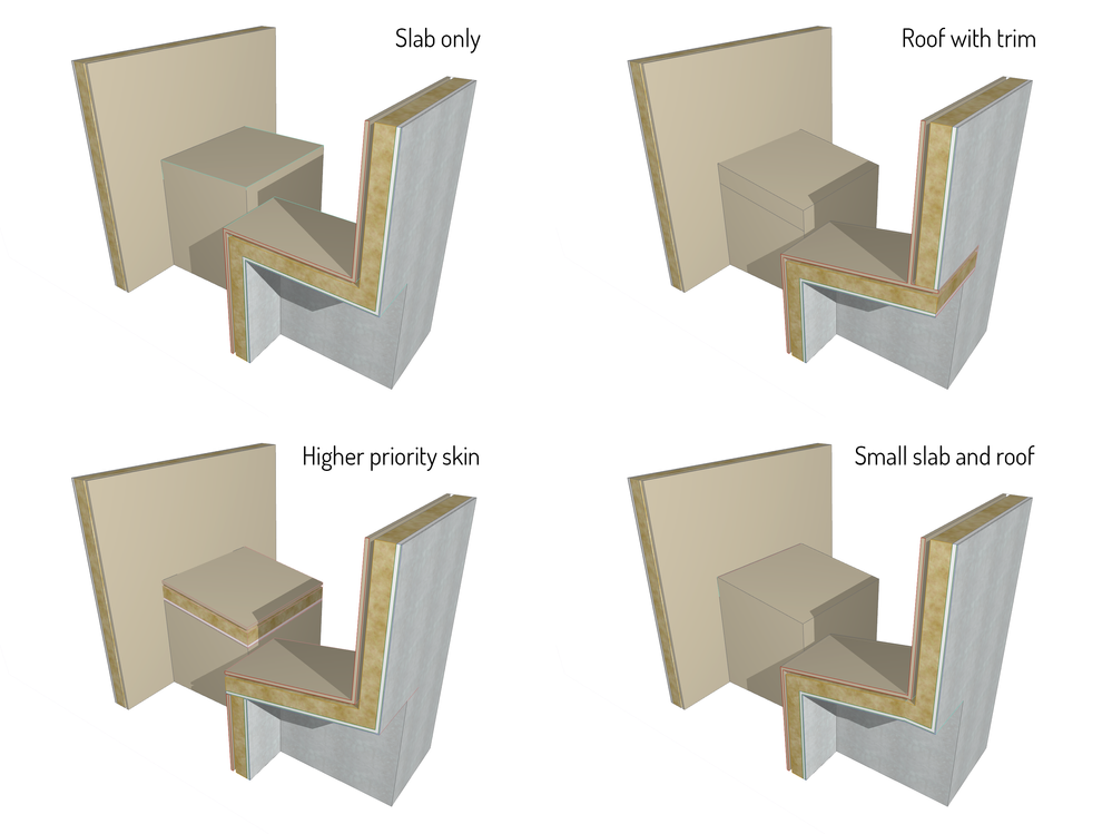

Recently, I've been using composites again, mainly because of the early stage energy modelling which requires a single component to represent the fabric. However, there's a scenario which never seems to work out - when a roof abuts a wall, or when a roof has a wall above, as is common with mixed roof heights, or lean-tos. See the attached image with generic skins:
1) Just using a slab works perfectly
2+3) Using a roof with trim always results in the inner or outer corner priorities not working correctly
4) Using a small slab with a roof abutting means the thicknesses are off and edges don't line up
I'm aware of trim/merge/SEO,with trim complex profiles, and different building materials with higher/lower priorities, but does anyone have a fool-proof way of modelling this basic junction? Thanks!

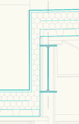

I can offer only a workaround: model the problematic Wall-Roof connections as a Profiled Beam and you will be able to achieve the correct skin intersections.
2x28" (2560x1440), Windows 10 PRO ENG, Ac20-Ac27
ocamorlinga
This is the solution I have right now. It's not perfect because of the subtle slopes the roofs have, I get odd intersections at the corners, but the sections come out clean. Also because there's two beams (one on top of the other) and only one of those is sloped, I have to overlap them, which means they intersect in 3D, but again this doesn't seem to affect the sections so I guess it's OK.
